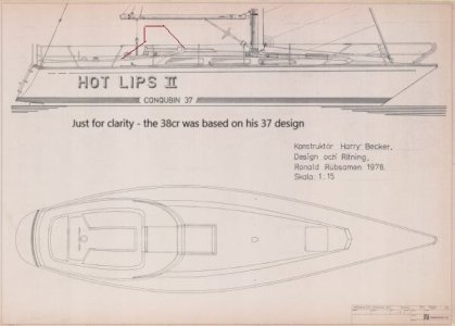

My discussions with maker will be not only to make the 'hood and frames' ... but also design features. My Motor sailer has the typical 'hood' that comes back quite a way from the companionway with only shallow angle from vertical to cockpit sides. Maybe for the Conq38 - the 'hood' will not come back so far - and have a greater angle of sides to cockpit ...
Superanne with minimal angle down to cockpit coaming :
For C38 .. I would consider a shorter top section and a greater angle to cockpit coaming :
Compared to the SR25 :
Imposed on profile of C38 :
