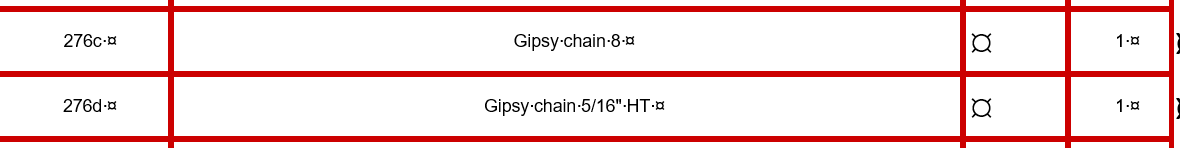

The difference between 8mm and 5/16" is very small but the Lofrans Parts List shows different part numbers for the gypsies for the two sizes of chain.
So the answer to the OP's question is - yes.
A 5/16 gypsy can be had for the Royale, but it is £279 and I am unlikely to be able to get one free to test. Whereas I should be able to borrow some 8mm chain to wrap round the existing 8mm gypsy.
So I am thinking new chain is probably the answer.
