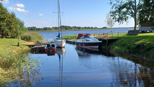

Its a long way to cable electrics to bottom of my garden .... plus the need for electricity both sides of canal.
On the left you can see the post that carries cable from BBQ area just out of shot .. to the pontoons. At present you can see the white cable hanging loose which then goes over the speedboat .. into the water and up other side to provide power to charger on the MoBo.
This is purely temporary.
Pal and I were talking about piping a cable across the channel ... but then an idea flashed in my mind .... Solar ? A complete independent Solar setup ??
Title says it all :
3 boats to run their chargers (3 x 10A 12v) ... + couple of lights and a music box in the sauna (its wood burner for the sauna) .. + a couple of LED floodlights ...
A solar system with storage battery ... ?? What size given that in reality - as long as the storage battery is sized sensibly - the solar system will basically be charging the boats mostly.
I'm thinking 2KWh solar + 2KWh Inverter / battery hybrid .....
???What would you install ??

My main task is to power the sauna and 'entertainments' ... secondary to sort the boats ...
I can of course stay with present system - just change the cross channel cable to longer heavier - so it sits on bottom of channel allowing boats to cross above it. But still have the issue of the sauna supply.....

I'm trying to keep the boats charged by existing systems on board ... which are mainly based on 240v supply to Victron / Mastervolt dual chargers.
I could hang panels on rails etc - but TBH - I am trying to avoid the hanging out panels - then taking them in ... stowing etc ...
The issues foundation comes from the sheer distance cables would need to run ... and that I have requirement for power BOTH sides of the channel.
If really needed - I do have a 3Kw Generator .... but who wants that drumming away ??
There is also the matter of Latvia being in the EU ... but that does not mean we have all the products here available ...
Looks like I shall be going back to trenching a cable.
