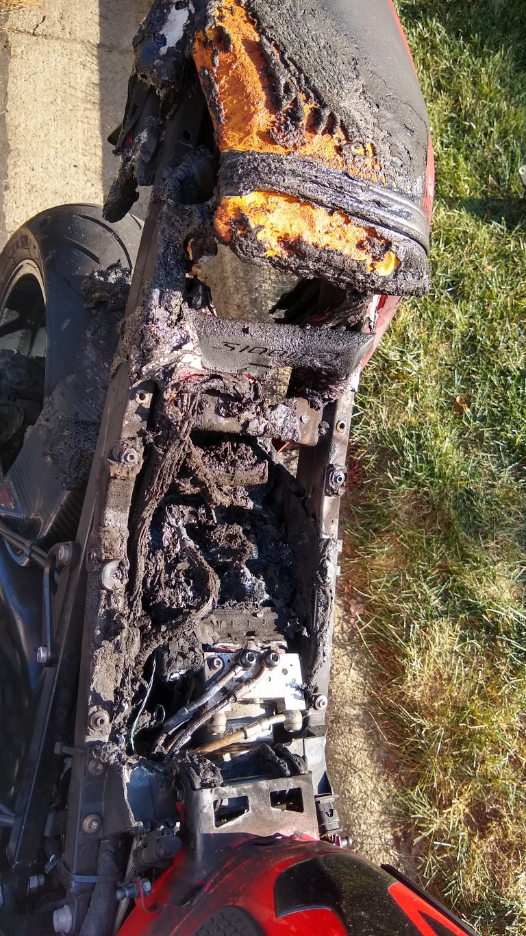

That doesn't look like LiFePO4 to me. It's noticeable that the meltdown of the boat battery (above) didn't catch fire. It could however have caused a fire through igniting combustible materials.
It makes little difference what the battery technology is, there is a lot of energy stored and it's all capable of getting very hot very quickly if not treated right. That's beoming increasingly true of lead-acid as people install ever bigger banks of batteries and ever more solar with questionable charging regimes.
You see enough threads on here where people really don't know what systems they have on their boat.
Most of the motorbike 'lithium' batteries seem to be FePO4.
It's not some binary thing 'Lithium Ion Bad, LiFePO4 Good' , there are for sure other flavours of 'Lithium-Ion' which are more dangerous, but no battery capable of whacking out hundreds of amps is exactly 'safe' in amateur hands.
