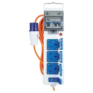

The scenario is a dayboat that is occasionally left on a mooring and owner wishes to charge batteries via 240v charger and also have access to 240v socket on board.
Rather that fit a full blown shore power hook up with dock cable, inlet socket, PCB unit and cable runs is it considered OK to use a set as used for camping as per the attached picture.

I don't see why not. The only concern I'd have is that I don't think those sockets are IP66 rated, so I'd make sure they are protected from the elements.

As post #2, keep it dry and no problem.
