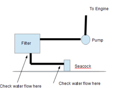

Is your cooling water inlet cock opening properly? Is the water inlet through-hull fitting chocked?
Disconnect the hose at the cock and open to test.

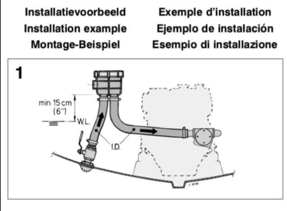

Thanks Gary. Vetus filter is 6inch above waterline........always has been. I ran a wire down the stop cock. It goes through when open and when closed it stops against ball valve. I could try to lower the filter to see if it made any difference? As I say, it has ran at that height for years. If I leave seacock open and try to fill reservoir, it seems to stay empty? Don't know if that is here or there.?
if the filter is 6in above w/l its unlikely to fill with the lid off. However if the pipe is clear you should see the water level where it should be.

Hi Lexi
If you remove the hose from the cock and open it does water flow?
RE If I leave seacock open and try to fill reservoir, it seems to stay empty?
This would indicate a blockage (Kelp, plastic, shell) between the inlet cock and the filter inlet ,
RE Vetus filter is 6inch above waterline........always has been.
That seems to be correct by the Vetus guide
