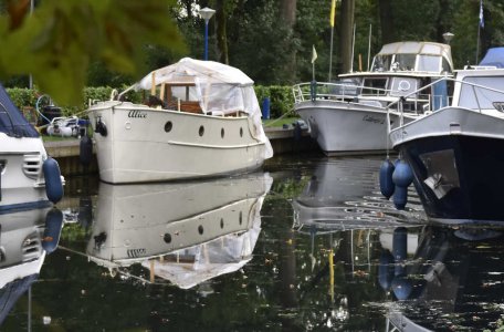

Our Marine Engine technician has a 100+ year old steel boat that has a preservation order on her, like yourself he is having to sort out a previous owners poor restoration, currently he is bead blasting the engine room to remove the lipstick off the pig.
Alice at the Blauwe Rieger Yacht Haven in Belgium:
