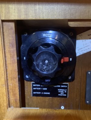

Ok so I know some of you don’t like these things but it does server a purpose. At the moment I can divert the house bank to the bow or the engine if needed in an emergency by selecting Both. OFF means just everything powers it’s designated thing. House, engine and bow are all separate.
I should be able to then select either bow or engine and divert charge to it. However when I select 2 for example, rather than just selecting Engine, it brings engine and House together.
This prevents me from manually charging the engine on its own from shore power. The only way to charge the engine on shore power is when it is grouped with the house bank.
Without looking at how it is wired, can anyone say where I’d start in order to get what I desire?
