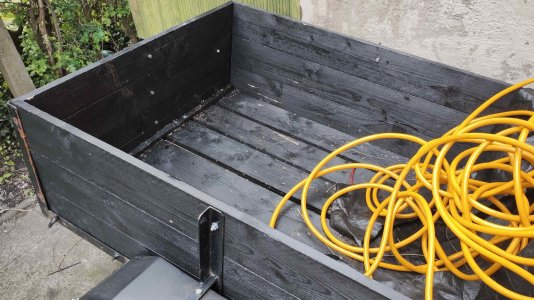

I did this job last month and used treated timber, painted with shed paint:
Wickes Treated Sawn Timber - 22 x 150 x 3000mm | Wickes.co.uk
Cost about £50 in total, I reckon it will outlast me. Had ply on it before which had fallen to bits. Spent a fair bit of time thinking about what to use and very happy with my choice.
