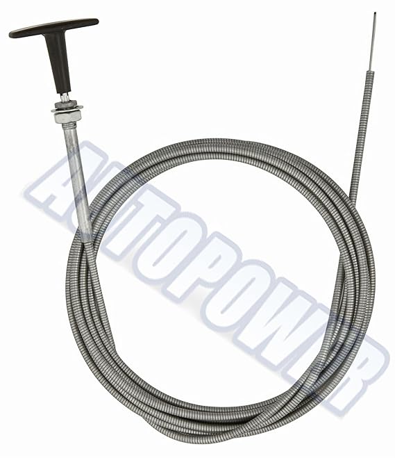

We replace ours on the 3GM30 with an "Ebay tractor engine stop cable" Under £12, about 1.5m long. solid wire core. Read handle . Easy job. Our original broke at Sanda on the way back from Rathlin. I had to go down and pull the lever manually a few times. Crude but effective. The Jeanneau / Yanmar price was silly.

That won't be happening now as the threaded section at the end with the T handle disintgrtated while trying to undo the retaining nuts. A new cable has now been ordered. ( One for a tractor not one for a Yanmar) Worth a try at a tenner. I'll bodge something out of it

Single very stiff filament on mine too. I discovered tonight that it was on about 6 inches at the stop handle end that was causing the stiffness so I managed to remove the ferrule cut a foot off the cable. Cut a new thread in the ferrule to replace the bit that broke off. And put it all back together. I hope I can find the T Handle that I took off today at the boat. I was too late to stop the new one I had ordered as it had already been dispatched. Oh well, no harm to have a spare in case my handywork doesn't work.stop cable1.jpg
