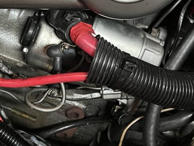

After a long crank with batteries combined and a failed start, I check the battery cables at the starter solenoid in the engine compartment and none were hot. The starter sounds as healthy as it ever did under my ownership. Are these the cables you mean?
