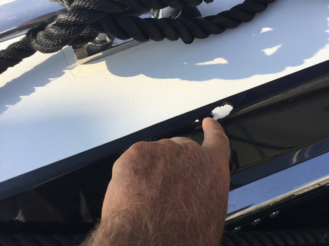

It is not fit for purpose in any way on a boat
I had a s65 wrapped then again under warranty ( which is just for the material not labour and the wrap companies don’t pay out ... 18 months later trashed again.
Water marked down it won’t come out. Rope will pull if it so much as touches it.
Comes off with water spray etc etc etc
For a stripe maybe. For anything else forget it unless the hull is knackered and you want a “ cheap “ fix to make it look nice.
My wrap was £6k on a brand new boat.
Don’t do it !

jrudge
4 Dec 2005
5,323
Live London, boat Mallorca
The waterline stripe Is usually a wet applied transfer. Wrap is self adhesive. I don’t know the technical differences between the two.
However ... a strip is small and are waterline level well away from enemy number 1 which is ropes.
As I said before for a stripe wrap maybe ok. For a whole hull based on expensive experience it isn’t !
Sailing boats have logo type wraps. I suspect there hide stains and colour variations better. Sailing boats are also a different shape that I would think gives better rope protection.
They say it lasts 7 years. It really doesn’t.
The fairline f33 was wrapped. They unwrapped it after a few days as it was coming off and looked terrible.
Another forum member wrapped his hard top. It has failed also which is well away from water and ropes - but of course gets a nice sun baking.
It was designed for cars not boats!
