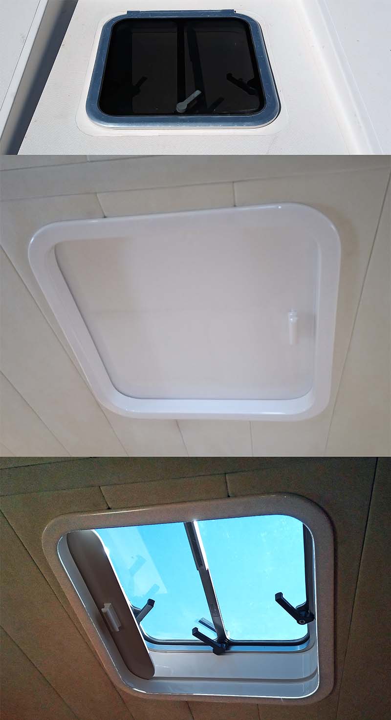

Sorry, in hindsight I appreciate that I was referring to the ceiling arrangement in my boat, which was actually custom built by the yard.
But one way or another, I've always seen bow hatches with some sort of internal blind, either rolling or sliding.
This arrangement is sort of irrelevant, though - what I'm after is a way to darken the perspex permanently, making the internal blind redundant, so to speak.
Anyhow, below is a pic of my current setup, just for the records.
Thanks everybody for all other suggestions, but I still think that an external wrapping is the easiest route.
