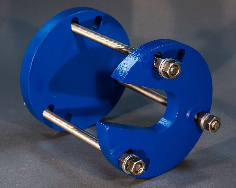

Hi Everybody a follow on to my previous posts.An engineer and two other boat owners have confirmed that my prop has
been trashed by corrosion and needs to come off.An unsuccessful attempt yesterday with two of the three legs of the puller so tomorrow I will be attempting to cut off one of the blades to enable fitting of the third leg.Wind up the pressure and then the blowlamp comes out.If that fails then plan is to cut it off being careful not to damage the threaded part of the prop shaft and the keyway. Any other ideas gratefully received.
Get one of these
https://www.ebay.co.uk/itm/Marine-Propeller-Puller-Removal-Tool-Boat-Yacht-Canal-25mm-/253344009944
