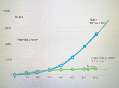

In the graph both chain and rope perform similarly upto about 300kg of tension - beyond 300kg of tension the chain has little ability to convert increased energy (from the wind) - but the rope continue to stretch (its not linear - but almost as good as).

I'm sure that your oft repeated graph means something to some people. It is noticeable, however, that it conveniently omits any information regarding depth. It's obvious that if anchoring in shallow water, chain will not give much useful catenary. Conversely, when anchoring in deeper water, the weight of chain gives a very useful catenary. There is good reason for deploying a stretchy snubber in shallow water, but in deeper water, decent sized chain is perfectly adequate, and much simpler.
30m of (decent sized?) 10mm chain, 5:1 scope - all given in the graph - what more do you need? Deeper water can mean less shelter (more wind), closer to open seas (more chop) - you takes your choice more shelter less catenary or.....

If you have a look at the graph at 300kg, 30m of 10mm chain 5:1 scope, there is effectively no catenary, or any more of any use, left in the rode - the ability of the rode to take an increased tension and further reduce the effect of catenary has gone - what you have left is snatch loads, on the yacht and the anchor. The snatch loads you feel on the yacht are the same as on the anchor - you are connected.effectively, by an inextensible wire.

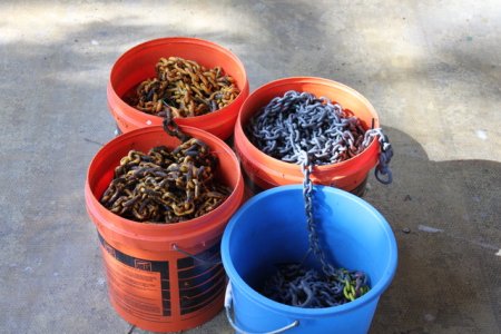

Heavy chain costs more, needs a bigger locker, needs a bigger windlass, needs more power. Heavy, or more, chain increases the benefits of catenary but a snubber does exactly the same by using elesticity, costs peanuts and weighs, almost nothing. There is absolutely nothing wrong with heavy chain - provided you accept the down sides - have I mentioned more weight, sacrificing sailing characteristics, costs more, needs a bigger windlass and more power - think bigger power cables.....maybe bigger battery
The 2 drums on the left contain 50m of G30 8mm chain, the two drums on the right contain 75m of 6mm chain. The 6mm chain has the same UTS and WLL as the 8mm chain (I checked them both). The 6mm and 8mm chain use the same shackles, UTS 10/12t; WLL 2t; 3/8th" shackles. The 6mm chain does need 'connectors' to take the same sized shackles but its an easy addition and done once. You can source the shackles and the connectors easily, mail-order or off the shelf, in the UK.

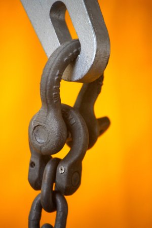

6mm chain attached with an Omega link to a 3/8th" shackle and a 15kg SHHP steel anchor.

Hi Johnathan,
Not sure about the relevance to this thread, of your last photo of a chain attachment to an anchor, but as a (retired) mechanical engineer, I'm not impressed by the finish detailing of the anchor. I don't know, or really care, what make it is, but the sharp edges on the attachment slot are horrible. It is evident in the photo that instead of the shackle load being spread over an area, it rests only on the two sharp corners of the slot. Not good engineering practice.
Hi Johnathan,
You said in an earlier post something about smaller chain needing more complex attachment than a 'standard' sized chain. I was illustrating the connection was very, very simple - even I can achieve a robust and safe connection. All the components are significantly over strength - the shackle has a 2t WLL, whereas the chain is only 750kg or 1t. The Omega link has a WLL of 1t.
The shank used was a developmental product and just one I used to illustrate the connection and take some photographs. The fabricator has bought a machine to bevel edges since and the slot in the end of the shank has been 'rounded'. This change or addition was made not to improve the 'mating' of the 2 surfaces but to improve the galvanising which had suffered from chipping in the past. Nevertheless well spotted.

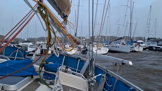

As a corollary, I was aboard my boat afloat in the marina during one of the vicious storms this winter (92mph recorded nearby). The forces generated by wind striking the boat in a sheltered marina were fearsome. This was shortly before I made the chain replacement decision!
