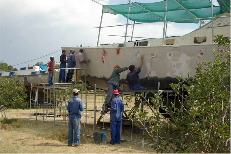

With the UK H & S you should use scaffolding frames one layer above the working platform.
I did that when I long boarded my boat and sprayed the boat.
Not sure and safety harness and fall arrester would work from the height you would be working from.
Note how my boards are notched to prevent the boards moving and falling off the staging.
I used steel lip channel for my boards
