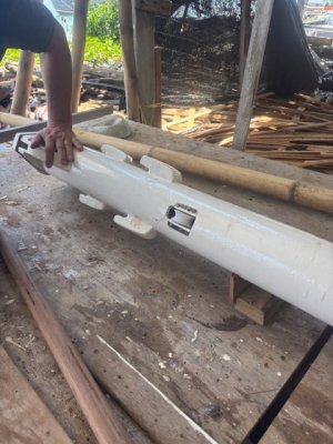

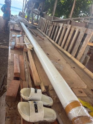

I thought some of you might appreciate seeing the wooden mast which my friend Fabien (a French boatbuilder in Sulawesi) has built for the Wharram Tiki 30 he is going to build for himself.
The mast is built of wood/epoxy. He built it in two halves so that he could epoxy the inside before bonding the two halves together and planing and sanding it round.
