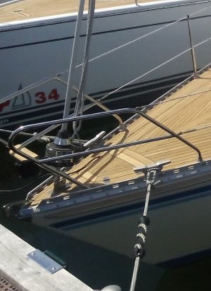

Here's the setup on Avy-J, works very well
I was going to say something similar and mention hawse pipe re-routing for access to the chain locker but being a newbie I shut up until I saw your post. They do have a great looking deck though so a perfectionist job will be called for. My first windlass was a royal lofrans, then wentvelectric.
