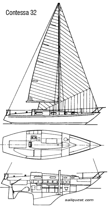

I think the Contessa drawing has been squashed up sideways in Photogshop from the original lines at some point. Don't have the original drawings to hand, but the hull is a bit more sleek than the drawing shows!
The Contessa length/beam ratio looks ok. She is in fact rather beamier than the side elevation often suggests. The Jeanneau needs beefing up, I think. I rather like the Dutch boat, but would prefer an encapsulated keel and no oval ports thanks.
Yup the plan from above looks about right. I suspect it may partly be an optical illusion - the original design waterline is quite a way below where in reality they sit in the water (design draft is I think 1.65m, but the reality is more like 1.9m), so the drawing gives the impression of higher topsides than in practise.
I wonder if practise has changed in this respect to give line drawings to show the yacht loaded - more flattering to yachts with high topsides?
