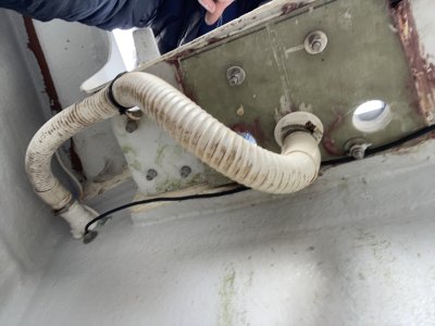

I had some issues with my windlass shelf and re enforced it with G10 plate. Here is a picture from underside - The brown goop is epoxy resin to bond to the windlass shelf. The white trunking is the windlass cables. If you’re bonding in a new shelf - use glass tape - and epoxy resin. Use big fillets of epoxy. Messy job but rock solid. Plenty of YouTube footage.

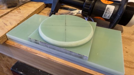

G10 for the win. This is for a new seacock. It’s going to be glassed in, don’t want to have to deal with remediating ply in XX years time if any moisture seeps out/in.
Easily worked with bandsaw, hand tools and drills etc.
