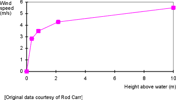

From my own observations, windspeed at a level six feet above the water tend to be one Beaufort force less than the reading from the masthead forty feet above WL. That means that the difference in actual mph varies according to windspeed, but it is significant at all speeds. The whole issue is complicated near land however, and you often seem to get a gust earlier (or sometimes later) at the masthead than on deck!
