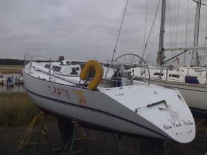

I believe (mostly from others accounts as i don't think i had been born at the time) that the IOR racing boats started the trend which was at the time called a retrouse stern, which was designed to make the boat look shorter and fatter than it really was, as they took length on deck and the aft gerth point into consideration. This had very little sailing or accommodation advantages (much the same as tumblehome). It was then copied by cruising boats which hollowed them out and called them sugar scoops which were much more useful especially as freeboard was increasing with new designs making it more difficult to get on or off the boat.
Here is a retrouse stern on frers 40 of the time. Not much use at all, except maybe as a slide:

: on a tea tray.....:D
