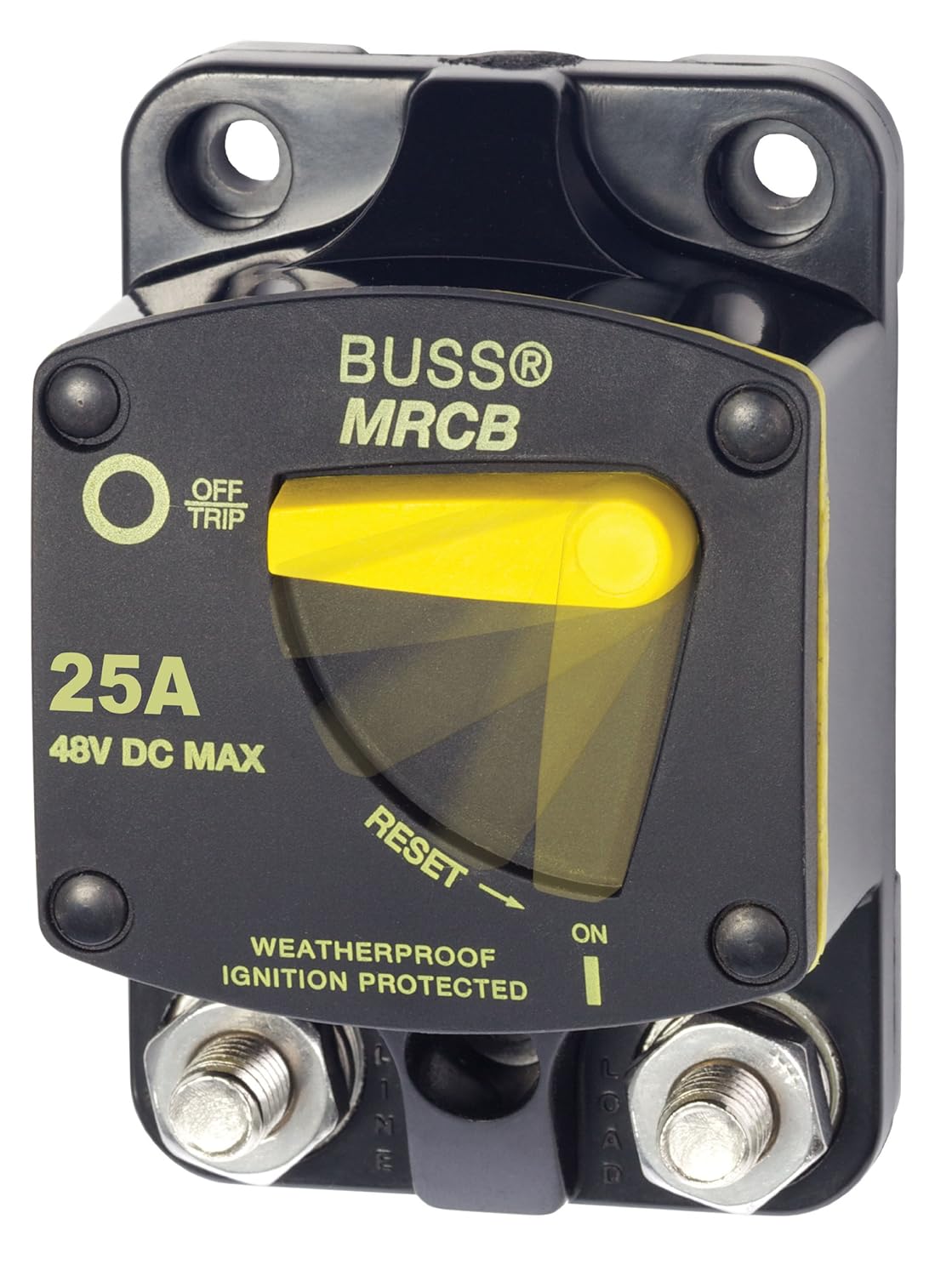

I'm looking for a 25 amp breaker that's going to give me minimal voltage loss.
Ideally something like this:
Unfortunately bar the Bussmann 25X which isn't available anywhere, they don't seem to exist anywhere in Europe.

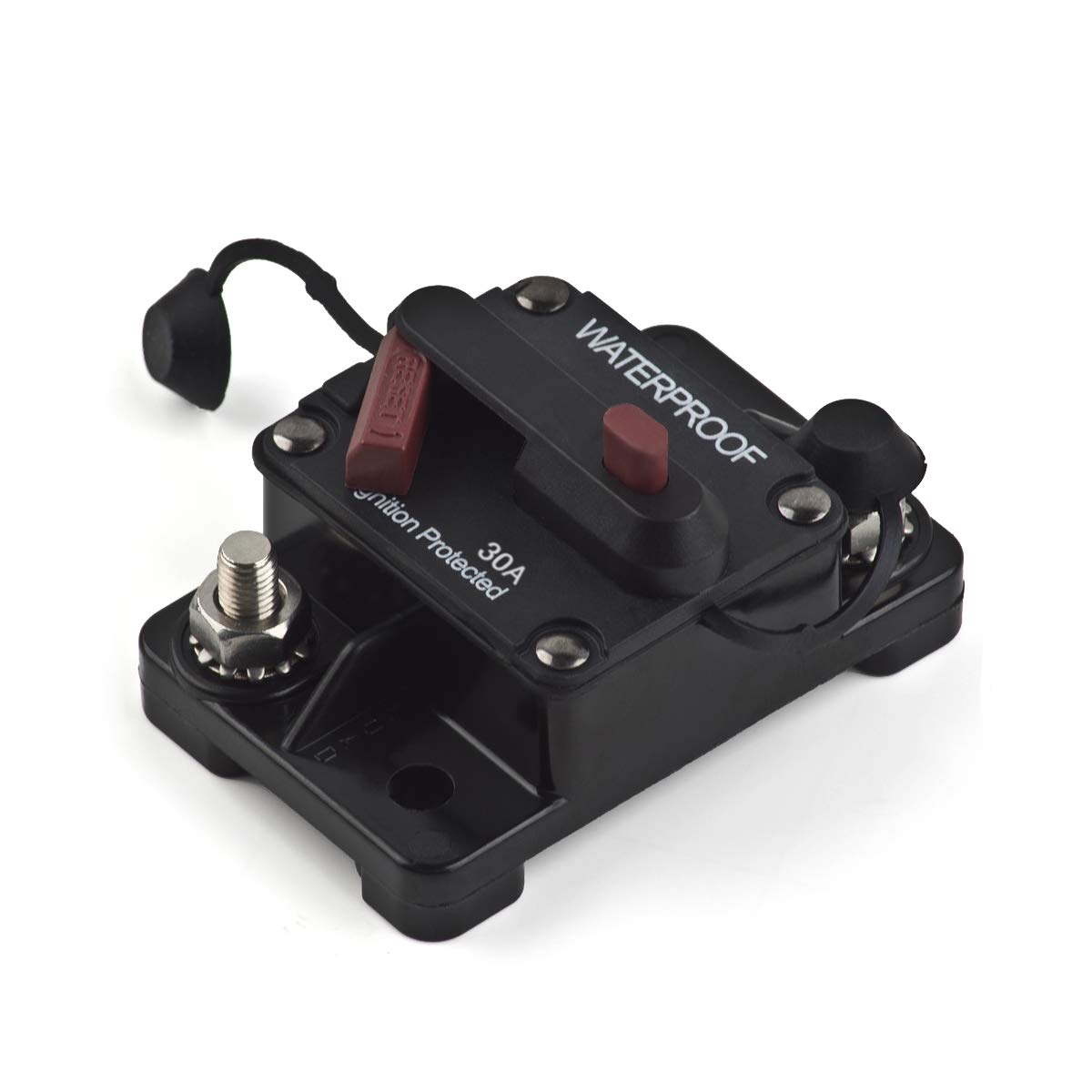

Bluesea 25A (£85 from Amazon)?
Bog standard 30A (£25 from Amazon)?
I have two of the 150A versions of the latter protecting my house and engine circuits.
