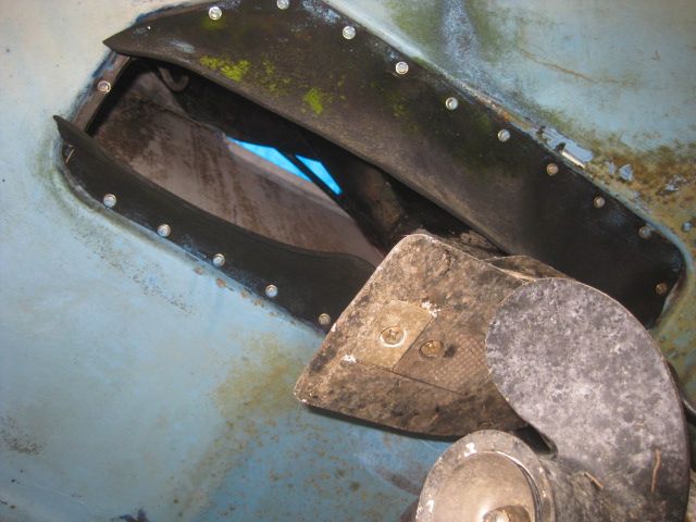

I'm interested in your 'fanny', I've been thinking of fitting something similar. Is it attached on the underside of the well? Any chance of a picture.

Pictures as promised
[/URL][/IMG]
Another here.
http://i1205.photobucket.com/albums/bb425/17234/Boat/OB Hull Entry 1_zpsekgyjxoh.jpg
It is fixed by stainless steel screws. What they go into I am not sure, it may be solid fibreglass or some sort of plastic, the other side of what they go into are within the outboard well. Mounted them on a frame and wedging it in the bottom of the well might be an option I suppose.
The rubber is now 27 yrs old and somewhat perished. New rubber may give a tighter fit around the shaft and less leakage of exhaust fumes from leg back into the outboard well when not moving. Whether it contributes anything to sailing by fairing the well I do not know.
If I replace the engine I will probably at least look at replacing the rubbers.

Friend has a a version of the pictured 'fanny' used rubber matting aimed at car foot wells and got a closer gap than in the pic. Secured to the hull (cold moulded wood) with ss strips and screws. bit of fairing at the forward end to help water flow.
