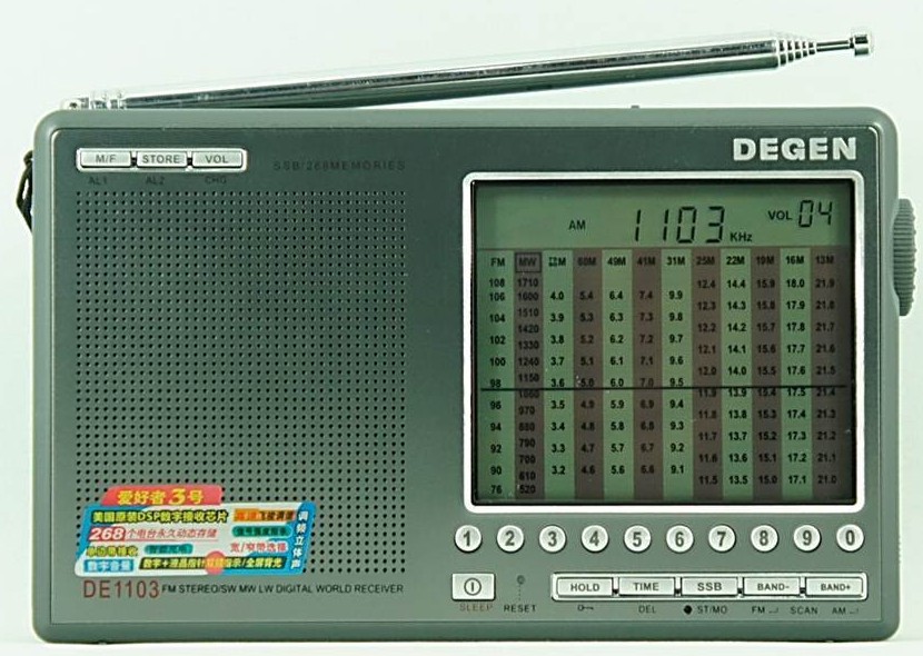

This is my favorite..
Degen 1103
As well as long wave and fm just add a tablet or smart phone and you can get weatherfax as well . and navtex Though the speaker is a bit tinny, I have it going through a little class t amplifier as well, which provides excellent sound for music and radio. Low power draw with both on.

Degen is by far the best bang for the buck - outstanding RF front end. But the User Interface takes some learning.
Have had a fun few hours seeing what we can receive when in the middle of nowhere.
The Degen seems to eat batteries, I have recently got a Tecsun PL310et that seems to be very good with better VHF reception and uses a usb power supply

Sorry to resurrect an old thread, but how do you find R4 LW on the Degen? I have tried and failed....
There are 4 ways you can do it according to the instruction manual'
  • By using the tuning knob
  • By entering the frequency ( 198)
  • By auto scanning
  • By selecting from presets
See https://www.manualslib.com/manual/735255/Degen-De1103.html?page=9#manual
Tuning knob doesn't work, flips back to top end of MW from bottom of that band at 520Khz. Same with autoscan. Manually put in 519Khz you can use the knob to tune lower again. Manual entry seems the only way to get past 520Khz.
Spot on, that was my problem. Your simple, type the number works a treat. Thank you.
