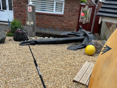

How about this one? Free to anyone who can carry it away, in the night.
We had two like that (ex-barge anchors) for our mooring in Dunbar harbour; they formed the bow mooring and we had lines to the harbour wall astern. They dragged one stormy day - but it was an exceptional storm, with at least one other boat in the harbour completely wrecked.
