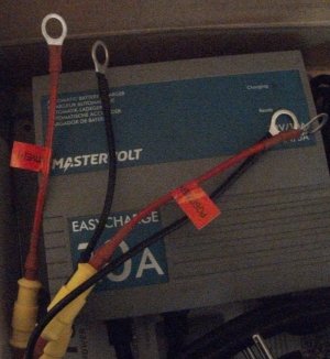

Next job is the Mastervolt system to the Motor boat ... which was original of this thread.
There's one niggle with it ... the unit has built in charge leads with large crimped rings at end of fuse lengths ready for battery connection. I really do not want to cut them off to thread them through minimal holes etc to get to batterys. As manual says clearly not to cut cables .. it would invalidate warranty if anything goes wrong with it.
I may end up joining my own cables to those rings to get around it. I'm hoping that I can feed the fuse holders through and seal up after ...
