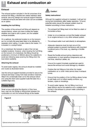

What does the supplier/manufacturer of your heater recommend? What heater do you have? If it's an Eberspacher their instructions for a marine installation say:-

Yes, swan neck is valuable.
Below is the relevant bit from the commendably clear and detailed Autoterm installation instructions relating to boats (this is additional to the general (vehicle orientated) details about exhausts, which provide info on e.g. silencer placement etc.).
Note that while I've heard some say that you need to have a drain hole in the exhaust pipe if this doesn't have a continuous fall from the heater to the opening to the atmosphere (unlikely to be achievable in most boats), the Autoterm instructions don't require this. Autoterm do say drill a condensate drain hole in the silencer if this is not mounted vertically as recommended (so that condensate can drain down the pipe).
