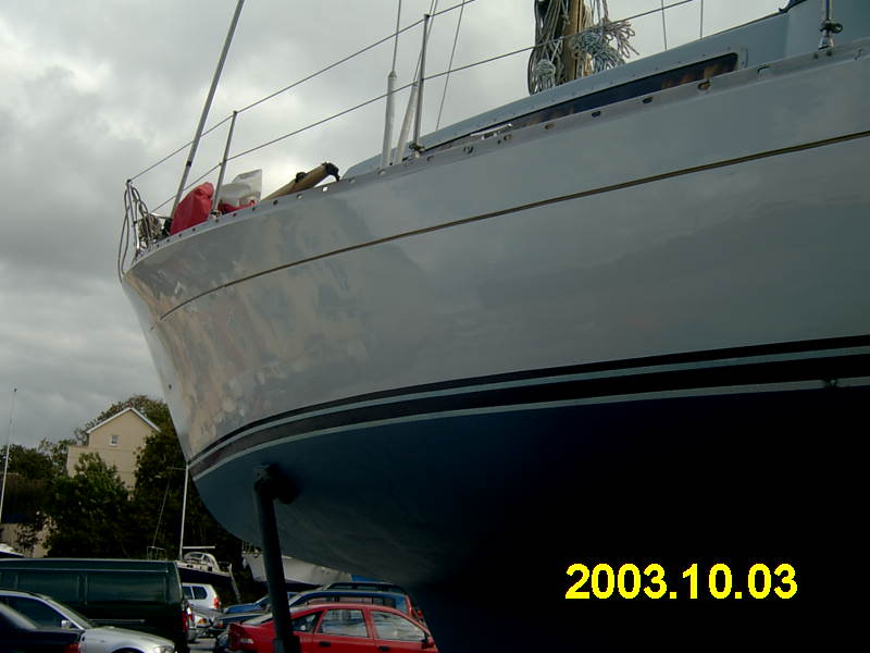

I am OK with falecla got some G3 already, along with 3m polish, all as recommended & I have used before. BUT am I really wasting my time with the existing gelcoat, I know its difficult without seing the problem, I can get a reasonable result (I think) on the hull, I did on a previouse boat here & that one was of a similar age, but it did have the advantage of being a Moody. /forums/images/graemlins/cool.gif
But the topsides are dinged & stained, /forums/images/graemlins/confused.gif even after repeated treatments & elbow grease, is there a topside paint system that will cover stains etc.
As she is in france I need to be able to do the work in sections of time, so I will take off the fittings etc. unstep the mast (do the mast boot, ariels, new wind system) sort out the windows. then do the repair work & paint.

You will find that all the linear polyurethanes from the major makers (eg International, Jotun, Awlgrip) as well as those from highly regarded smaller manufacturers (eg Altex here in Australasia) will perform very well if you go the paint way. It is also very cheaply repaired in comparison to gelcoat in the case of dings etc, but as with any it pays to use an easily matched colour eg white.
Our boat is nearly 9 years old now and was painted with polyurethane (Altex) when built and it is years away still from needing its first repaint. And that even though paints have a hard life here in NZ due to high UV levels in comparison to many places.
John
The problem with painting is that it tends to smooth ou the non skid surface on the deck. Therefor try agressive cleaning of the deck first then try to match the gelcoat colour with either gelcoat or Urethane paint to touch up the damage or consider just painting the smooth parts same colour as the antiskid parts. Straight white is great for colour m,atching but can be very glary in the sun. olewill
