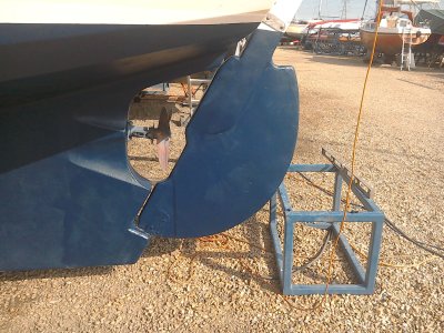

Back to bare wood, then 2 coats of Primocon and 2 of antifouling. Above the waterline white Toplac
As photo before final coats

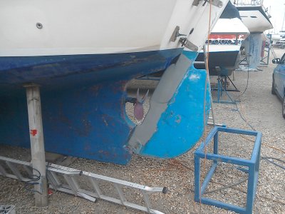

Not sure why one would want to paint it with "topside" paint first if it is going to be antifouled. Recommendation from all the paint manufacturers is primer such as Primocon then antifoul. Just as in post#4. The grey part is new wood and primed ready for antifouling. final job here
