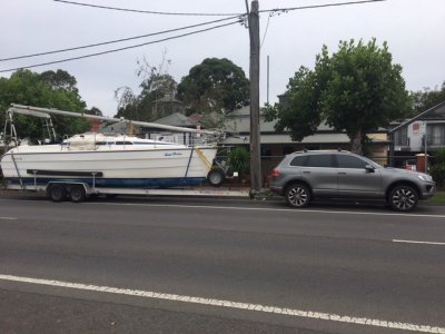

An alternative choice! Imexus 28 Powersailer.
8.5 m, (28 foot long) 180hp Yanmar turbo diesel inboard, aluminium trailer weight 620kgs, yacht on trailer with extended live onboard cruising gear but relatively empty fuel and water tanks about 3400kgs, max speed recorded in light ship mode under twin counter rotating props on leg was just on 30knots, 25 knots in loaded mode, width 2.5 metres, height when trailering with mast on top of targa bar and Bimini 3.8 metres high.
Standing headroom of over 6 foot at galley, enclosed shower toilet with hot water, twin generous permanent double berths and 1.5 single berths. Dinette for 6/8 not deconstructed for bedding.
Range unlimited due to ability to sail as well as motor, draft 30 cms (1foot) and dries out flat, can motor in under 60cms (2 foot) and sail in 1metre in gentle conditions needing 1.45metres in full sailing mode.
I cannot think of many strictly powerboats that are as accommodating or flexible for longer periods staying onboard or as versitile for everything from towing skiers, to extended cruising on inshore and inland waters whilst remaining easily trailerable and with one person launching, rigging and handling. 🙂
Only just noticed it’s a resurrected very old thread!😂
