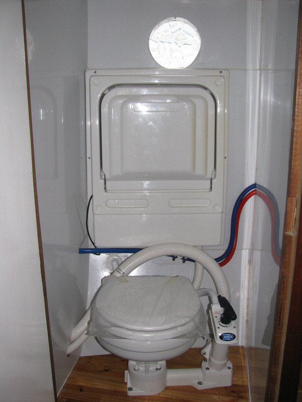

Possibly not quite what you are looking for but this is the heads compartment on my little motorsailer. The walls are lined with 2.5 mm PVC sheet. Mine are white but it comes in marbled and other colours.. My corners are fairly sharp right angles but it is possible to buy a wide variety of mouldings that might do yours. Alternatively, PVC is easy to shape using a hot gun and can be welded.
