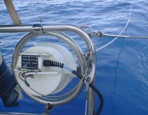

Has anyone ever tried one?
Before they where 5k+ but now the little 300w one comes in a little cheaper 3.5k?
http://www.bruceschwab.com/uploads/watt-sea-retail-pricelist-ope-20142.pdf
at 5 knots would it power a hard worked ST2000 basic nav stuffs lights GPS wind Depth etc
It will also be near the rudder so will have some losses due to that.... Not having space for solar or liking the noise for wind and an Auto Pilot that once the wind pipes up hammers the batteries this seems like a good option?

Interesting, but how does it compare to that dual mode thingy that Iv'e seen on some yachts. Whatsit called???
From what I can workout it claims to produce more power for less drag. For me as a coastal sailor with no charging on my home berth it would be ideal for keeping batteries fresh whilst sailing, if its as good as they say... But the advantage in my mind is hook it on and put it down as you leave then haul it up like a dinghy rudder on your return.
The racing varieties seem to have a good reputation but then they are going a we tad faster then my 5 to maybe 8 on a good day, with very rare excursions above....
Unlimited use of autopilot and possibly phone/ tablet charging under way seems like a nice goal to me...

Not sure if they were watt and Sea hydro's but the one thing that sticks in my mind is that Alex Thomson had two of them (in the last VG) and they kept breaking down all the time, Mike Gascoyne's also broke down on his first transat.

I saw a different type reviewed over here. It is retractable under the boat and is very efficient. You can also use it in the other sense to propel the boat over short distances. About €30k....

I think one of the minitransat boats used one successfully last year. The imoca guys used them but with a few problems with the mounts. Of course they were shifting a bit. Although I'm not in the market at the moment I would be seriously considering one rather than a windvane steering system if kitting out for long distance. Of course putting all your eggs in an electrical basket may not be the best option but they've had some serious real world testing now and appear to be pretty good. Add solar and a wind genny and you could be looking at some very usable power.
