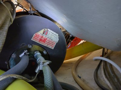

If you mean an accumulator, there isn't one and, given the lack of space under the galley sink where the pump is located, I can see why but thanks for the offer.It sounds like the pressure thingy (normally next to or attached to the pump is knackered. It should be half full of air with a membrane in the middle to stop the air dissolving in the water. You might be able to pump it up with a bike pump attached to a the fitting for doing that. Pump it up to about 1.5 bar.
If that doesn't do the trick, then you need to change the pressure reservoir.
