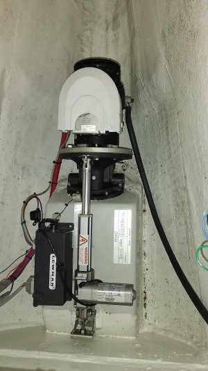

I have a Lewmar swing thruster, 15 years old, so not a new style. It's built into a space in front of a watertight bulkhead in a 35' boat. No leaks.
