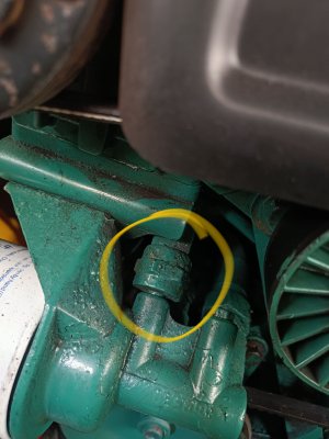

Hi guys,
So just to update, oil pressure gauge is reading a solid ~60psi with the engine started from cold and the warning light is illuminating almost straight away.
Safe to say it's a dodgy senor supplying warning light?
Is it the one circled below?
That looks like it. I would look the part number up online. I just changed one of mine, Volvo wanted £100, patterned copy was £50, one from China was £25 delivered.
