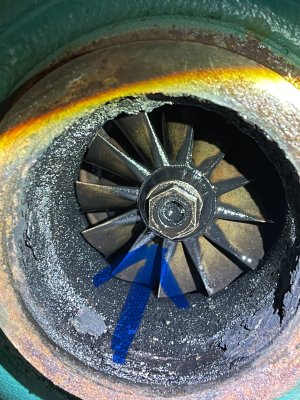

I previously posted that my turbo was sticking and I managed to free it a bit.
I plan on taking a power drill/screwdriver and continue to spin the turbo to further loose any corrosion jamming it.
Q: can I simply use the hex head (shown with blue arrow below) on the exposed turbo shaft to turn the blades - or is there a chance I would loosen the shaft retaining bolts and risk the blade/shaft disassembling?
I just used an electrical screwdriver (that sort of size) and just scraped it around where the rotor goes. I take it your rotor will move although just a bit stuck. Don’t put any pressure on the rotor or you might deform it. When you can achieve a couple of free spins, job done
It spins mostly without any jams - but there is a bit of friction for about 1/4 of the turn.
Someone suggested spinning it with a drill to clear off any remaining corrosion, which I assume is in the body of the turbo housing.
I wouldn't be worried about the nut.
But I would be a bit worried about damaging the vanes if too much force is needed.
UPDATE: Spun the turbine with an electric drill. 99% freer spinning.
Took out for test - all good. Then did 2hr at cruising speed and some WOT. Issue fixed and I expect it shouldn’t reoccur this season.
Likely I’ll strip at winter and get it refurbished.
