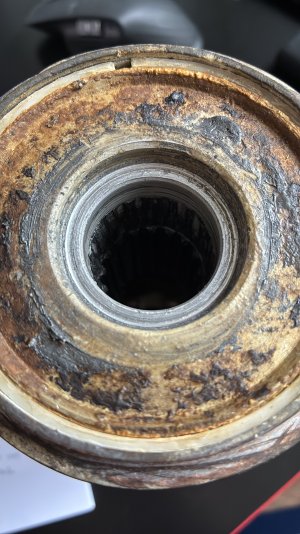

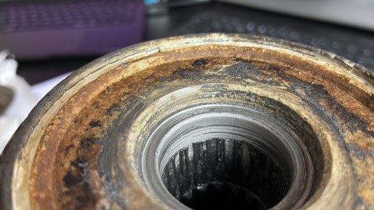

This is how the propeller hub looks like. Is the solution to get a new propeller hub? Or is it possible to find some other type of fixing?

Unfortunately I'm likely to be the bearer of bad news having gone through this pain last year...
If you can establish that it's definitely not movement of the prop against the shaft i.e. the prop splines are firmly fixed to the shaft, then it's the rubber bushing. VP saildrive props use a hard rubber bushing between the shaft and prop body - this has two uses, electrical isolation and to shear if the prop hits something so the saildrive gearing isn't damaged.
Our prop came out wobbly like that last year, we thing because we overused it at high revs when the prop was dirty towards the end of the season, plus it was over propped by the previous owner anyway. This strained the rubber bushing, which feels like a design flaw as it's not really an impact.
We took it as an opportunity to upgrade to the new hub model with curved blades (not backwards compatible to the square blades we had/you have) and a better prop size. £1500 down and no problems this year at least.
Edit: to add I tried a few companies but I couldn't find anyone would could replace the bushing in the UK.
You might try here darglow.co.uk to see if it can be rebushed, or you may be able to buy just a new hub and reuse your existing blades and pins. If it is not economically repairable then suggest you replace it with a Flexofold which is a much better propeller than the Volvo one.
