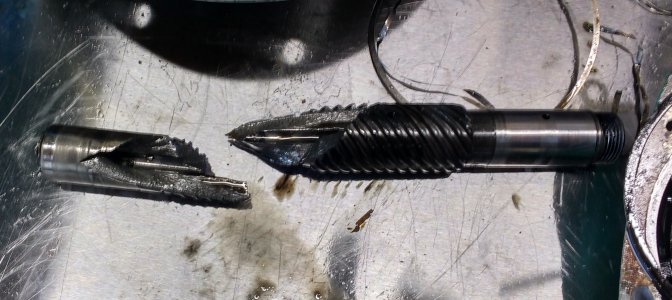

Any search on the interweb should produce an exploded diagram of MS series gearboxes.
Two points of view on this gearbox and before deciding on a course of action worth remembering that this reverse gear has been around since the dawn of time and probably tens of thousands are still out there doing stirling service in thousands of boats.
The fact is that very few actually fail, prop strikes mainly , majority certain bits simply wear out.
The diagrams will show a very simple piece of kit and Volvo Penta still do make some parts.
Box can be physically removed by a single keen & fit tightwad DIYer in an hour or two, no need for expensive yard based boat ashore job or Hi Ab etc to get unit out of boat.
Simple to remove, however finding somebody to diagnose the fault is where the problems start to arrive.
Most marine gearbox menders only appear to want to repair hydraulic boxes, this may well be because parts are commonly available and probably a profit still to be made, suspect that repair shops have spent time pulling apart too many MS boxes , wasting time and money , to find the owner reluctant to cough up for an unrepairable gearbox all in bits.
A couple of things to consider, secondhand units are rarer than sunny summer days ( it will need to be the same ratio) and any replacement new gearbox involves moving engines and extra plumbing.
VolvoPauls diagnoses is probably spot on .................as always :)
