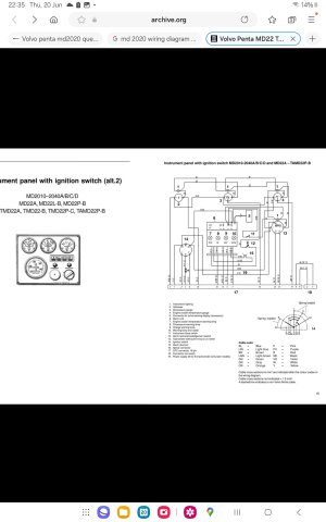

Ive found this wiring diagram for my instrument panel type, but just cant find the other part which shows where the wires from the connector plug go to ?
The wiring diagrams are in the owners manuals for VP engines of that vintage.
If you have mislaid your manual you can downlod one from VP's website.
Manuals & Handbooks | Volvo Penta UK & Ireland
All you need to enter is the engine model number eg MD2030B.

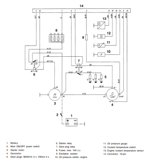

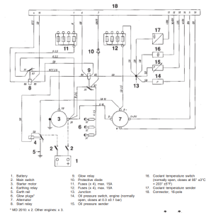

That would have been very helpful but i can't find a serial number to enter and just searching md2020 is not enough to search.
You do not need the Serial number. You only need to enter the model number ( eg MD2030 ) in to the product designation box and pick the appropriate model from the drop down list
However
1719012525311.png For the earliest (A series ) engines. with an isolated electrical system
1719012793916.png For B, C and D series engines

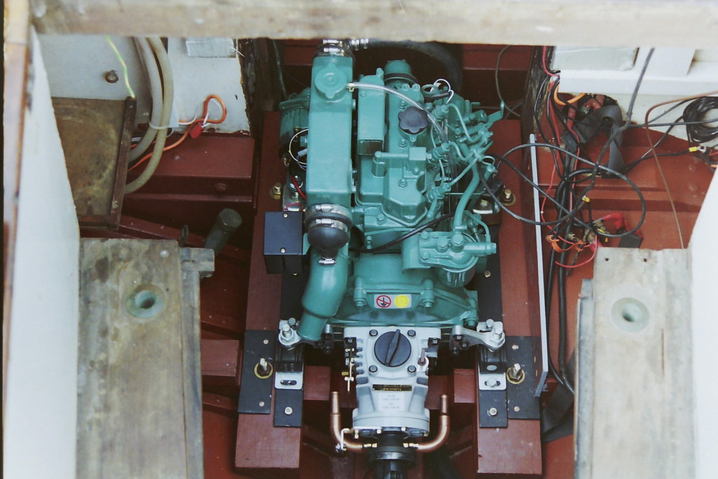

Wow at tillergirls engine. I wish mine looked like that !
Im making progress . Its a 2030 in a chieftan/centaur. Should go well !

tillergirl
5 Nov 2002
8,452
West Mersea
It is NOT an engine. It is a sewing machine. Perkins heritage, smooth as a dream. Actually my dreams tend not to be smooth. No seriously, it is a very good engine. Photo taking at the time of installation. I had to sell TG 24 years later on account of arthritis and the engine was still smooth and started instantly. Over the years apart from new fluids and filters etc all I need one new set of glows. One service of the injectors wasn't expensive.
