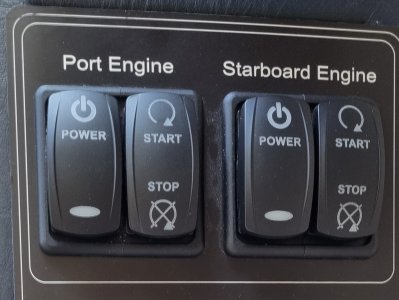

I have just changed my switching arrangement to push button stop/start, so have some spare key switches.
