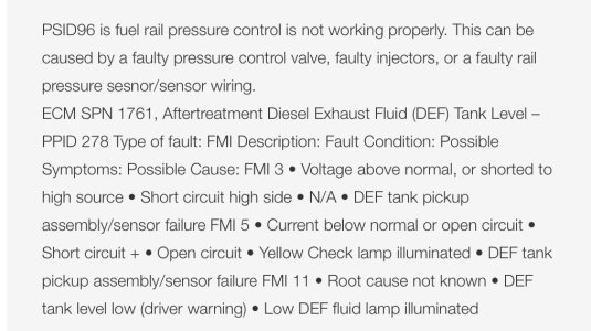

Hello, I changed the timing set and bought it properly, it gives a fault code of mid 128 pid 96 fmi 12 in the system. I've been searching the internet for the error codes for this, but I couldn't find it exactly, can you help?

If you Google “ mid 128 pid 96 fmi 12 Volvo Penta “ crucially adding the Volvo Penta
Throws up …..fuel rail issues highly likely a sensor or it’s wiring start there .Bad news the pump .This is generic Volvo .
Check you have buttoned it all up correct, disturbed any wiring ?
Good luck with it .
