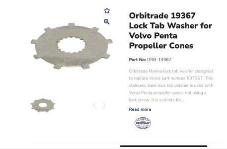

Hi all, Happy New Year. When our boat was craned out at Chatham Marina one of the props was damaged, the previous owner kindly removed them and posted them for repair,so as I have never worked on the 2 x AQ270 out drives are the props just a push fit and you tighten the cone or is there some tabs that need locking etc?
I have seen online there is a washer to stop fishing line getting behind the prop,then the prop,then a grooved washer and cone, I did plan on just tightening them up but don't want them to drop off if there is a locking washer I need to bend
There is a large washer with tabs on it. The cone should have lots of recesses at the back to bend the tab washer bots up in toIMG_1074.jpeg

There is a large washer with tabs on it. The cone should have lots of recesses at the back to bend the tab washer bots up in toView attachment 170169
Thanks for that, I remember seeing them when I was changing the Anodes, the previous owner did me a great favour removing and sending off the props but hate putting things back after it's been removed by another person, think it stems from when I rebuilt my cousins Suzuki GT750 engine after his mate had taken it apart lol. Just need to get some time off work and get over to put the props and new Transducer on
