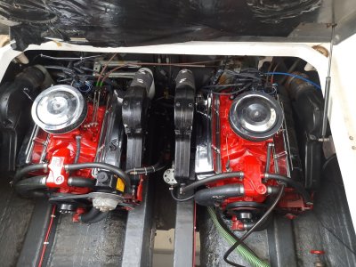

hello to all, I have a twin volvo penta aq200d petrol engines in my old Fairline Corniche 31, both engine runs fine and are well maintained, the issue that I am finding lately is that one of the engines don't rev higher than 3200 under load, while the other goes up to 4500.
The thing is that when in neutral, it does rev up, but not when the gear is on. Plugs are new, cabling of them too, petrol pumps runs well, .. not sure where to look for, thanks in advance for some good tips, cheers 🍻 !

Have you tried revving directly from the throttle lever on the carb/s in case the cable or control is faulty?
not during load in the sea, but when in Neutral it does go up to max revolution without any problem, so that should somehow answer the question on the cable potential fault

Fuel filter would be my first check. I have twice had exactly your experience with diesel. Not sure it would be the same with petrol as their function is very different but my philosophy is always to try the easy things first.
Are these carburettor or injection? Float level should be a clue if the former.
Izy
23 Aug 2022
9
Carburator based, and was checked, working normally, this is keeping head busy, thanks for the hint
