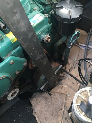

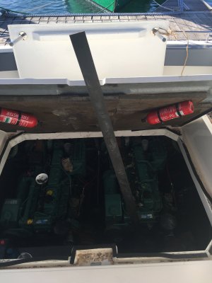

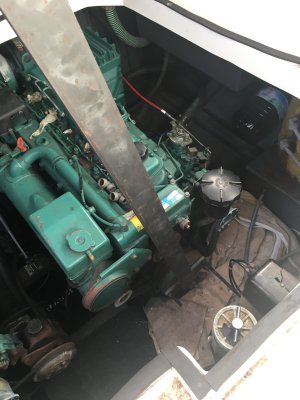

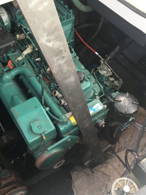

I have two AD41’s and one has also stuck. I have tried rocking it back and forth using a 2metre “T” bar bolted to lower pulley wheel, tried filling the cylinders with auto transmission fluid and acetone yet still no success. Frightened that anymore pressure will snap pulley wheel keyway.
Any help appreciated!
