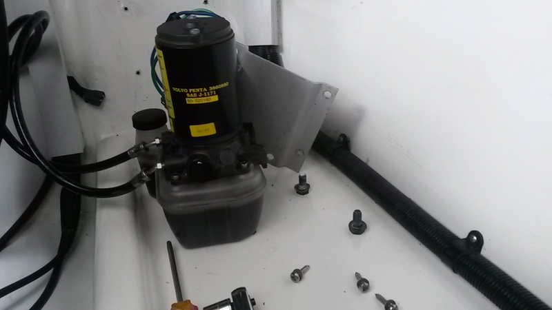

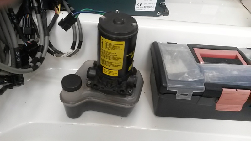

The removed pump assembly. There is nothing wrong with the electric motor or the reservoir.

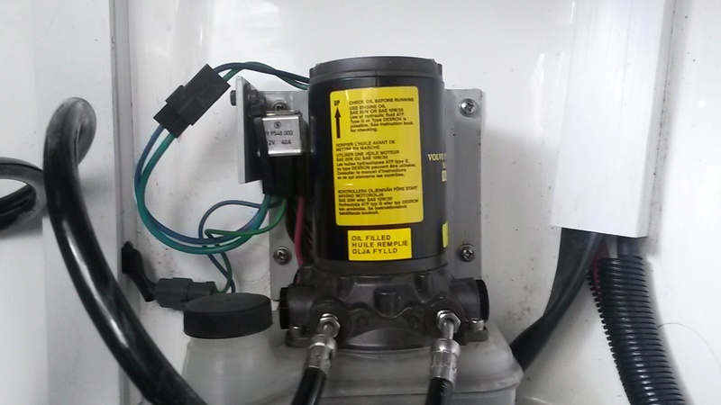

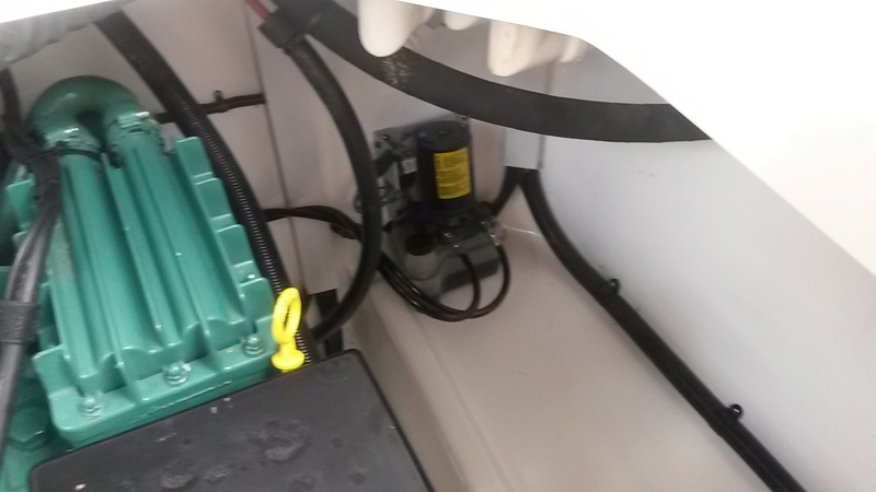

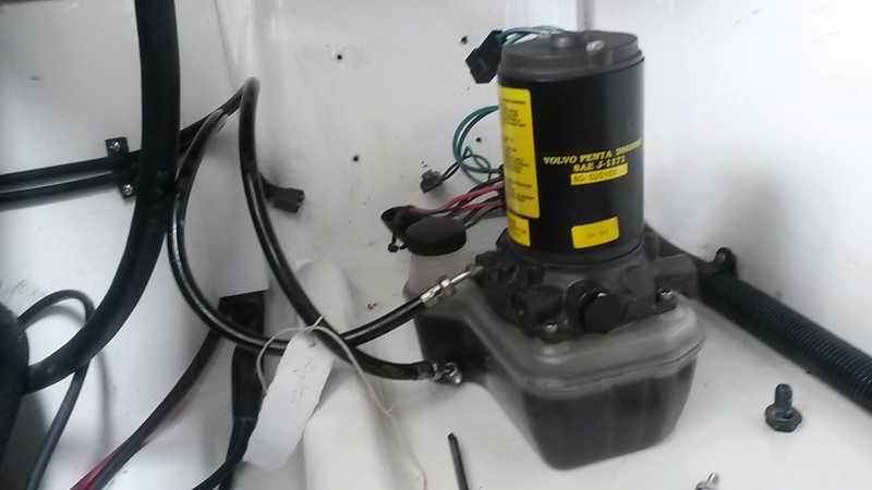

The pump for the starboard engine is not quite so accessible (sorry for the bad focus). *One screw dropped into the bilge took quite an effort to recover.
But I got there in the end and now have the two pumps swapped over .
Testing the trim shows the fault has moved with the pump. So it confirms with no doubt the pump is at fault and not the rams.
I don't think the pumps can be repaired , unless any of you good people have any suggestions.
So I think a complete new pump and motor assembly seems to be the way forwards.
