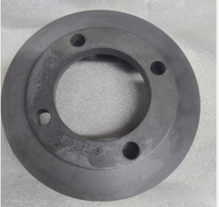

if your pump looks like mine with the pulley behind.....I had to buy a “conversion” pulley which bolts on the front

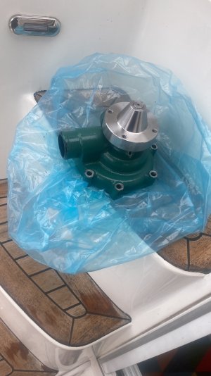

Hi Alt , Mr Googler and all Involved in this thread
I wonder if you can help me out
Bought a New Pump - ( Well Re Manufactured version) Part Ref was probably 3809412 on my KAD32 ( Number Replaced by ) 23059414 - this last one --- is the one I got and it looks like the one in
your image above LEFT and Mine RIGHT
However my engineer is saying the Pulley needs to be changed - Mr Googler suggests above he needed a Conversion Pulley - Can you please let me know the part number for that Pulley Please
also if you know where is the best place to get it and roughly how much - I know I don't want much lol
any info would help
Cheers all
Volvo part number 3588385 about £80-100 - but double check that, I got the part number off an invoice from 3 years ago.
