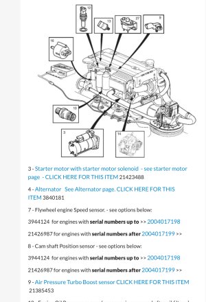

Where exactly is the boost pressure sensor on these?
Diagrams are hopeless.
Actual photo much appreciated.
Part No 9, I think.
