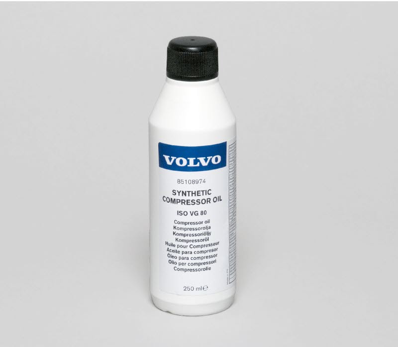

Volvo compressor oil - a possible alternative source
But then this bottle shows ISO VG 80. I'm not near my Volvo bottle atm so can't comment
I think you need the ISOVG80, it used to be VG68 but now you can only buy the VG80 volvo branded. The 68 or 80 is its average viscosity at 40 °C mm²/sat and its price is way off at VP original so good initiative finding alternatives.
Sorry guys but £20 worth of oil will cover your supercharger for 1000 hours unless it goes milky in colour, what is the point of trying to outsource another cheaper oil that your not 100% sure will work.
I would price up a new supercharger then decide what oil your going to buy next time.
+1
and from memory it's every 5 years and one bottle serves two on the KAD 300 ,s
So if this none VP stuff is 1/2 price you save a tenner like 0000.1 % of total cost of boat ownership ?
For what ? Potentially knackering your Superchargers !
