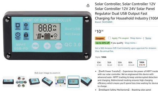

The dictionary definition of a "no-name" product is packaged and sold without a brand name and usually at a lower price than similar items with brand names; generic (Collins dictionary), but is often extended to include "having a name that most people do not know; not well-known" (Britannica Dictionary).
It is a little like pornography, hard to define, but you will know it when you see it :).
Below is a particularly bad example on Amazon from the Giant of Sun brand. Avoid this type of controller.
Giant of Sun 100A MPPT for under $11.
Epever are an established brand of solar controllers. They are not a “no name” controller and are popular in caravans and RVs. They make many different models of controller both PWM and MPPT models. These don’t have all the features of the Victron controllers, but most of the important parameters can be adjusted by the user. I have not seen one in action to comment on their performance. The brand was included in the test I linked to in post #33. Here they did reasonably well delivering only 2.6% less energy than the Victron controller.
